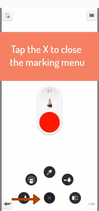

The Marking Menu in the iOS version of Autodesk SketchBook The Marking Menu showing tools in the iOS version of Autodesk SketchBook
Marking menu
Use Clutch (the marking menu) to access an assortment of tools, as well as the corner tools without going to the toolbar. If you are working with the interface hidden, the marking menu provides access to a host of tools without unhiding your interface.
Within Clutch (the marking menu) are tools for switching between the current and last brush, flipping the canvas, selecting a color from your screen, accessing the Double Puck, and Transparent Color.
The marking menu with an option selected in the iPad version of Autodesk SketchBook
