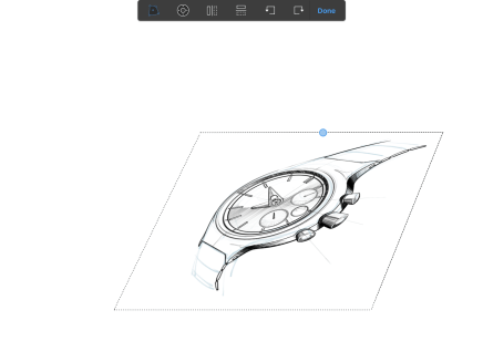

Distort, you can drag the handles
in any direction to distort a selection. Since they aren’t constrained to 90 degrees, you can use them to create a sense of perspective or speed. Content is automatically stretched to fit the confines of the newly-shaped bounding box. Move the handles to force perspective upon the contents of the bounding box.

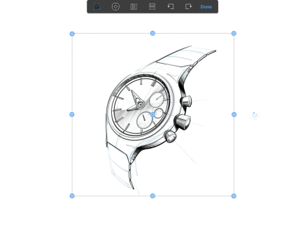

What is the bias
When using Distort, you will see a manipulator in the middle of the bounding box
. This is the bias. Use it to foreshorten, change the proportions of a sketch, or change the actions of a character.

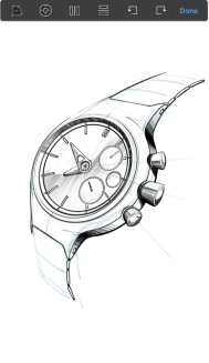

In the toolbar, tap
Transform and select
. A bounding box appears surrounding the content.Tap-drag the outer handles
to automatically stretch the content to fit the confines of the newly-shaped bounding box.Note:Since the handles aren’t constrained to 90 degrees, try using them to create a sense of perspective or speed. Move the handles to force perspective upon the contents of the bounding box. Use
in conjunction with the perspective guides to fit something into a scene.Tap-drag the central handle, Bias, to foreshorten, change the proportions of a sketch, or change the actions of a character.

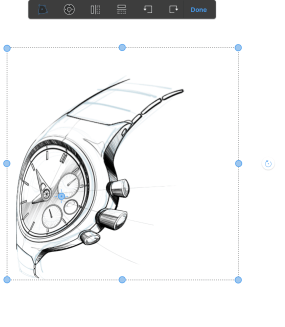

Distorting a selection in SketchBook for Mobile
Tap
and select

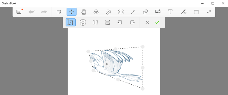

Distorting a selection in SketchBook for Windows 10
The Distort tool is found in two places, in the Transform and Text toolbars. This means you can stretch both images and text.
Distorting images
In the toolbar, tap
and select

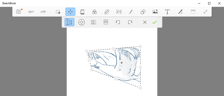

Distorting text
In the toolbar, tap
and use the Text tools to create your text.
When your text is completed, select
in conjunction with the perspective guides to fit something into a scene.Tap-drag the central handle, Bias, to foreshorten and change the proportions of the text.
