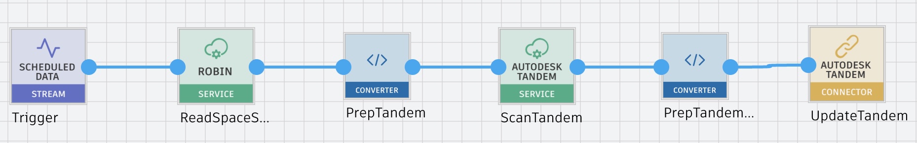

Pipeline
Components Involved
Scheduled Data Stream
Initiates the pipeline, scheduled to run daily but customizable with an enhanced scheduler. The stream plugin is preloaded with default mapping of robin properties to tandem. If needed please change them. Below are the pre-loaded JSON for the scheduled data stream.
  "mapping": {
    "RobinCategory": "Robin",
    "SpaceId": "SpaceId",
    "Availability": "Availability",
    "LocationId": "LocationId",
    "Presence": "Presence",
    "Next": "Next"
Robin Service
Specialized to work with Robin API, reads space state objects for all spaces in Robin instance using API key and Organization ID. Configurable to read spaces of specific locations by mentioning location name in plugin parameters. Outputs space state objects like below
  "pathParameters": {},
  "data": {
    "spaceId": 269556,
    "state": {
      "availability": "available",
      "present": 0,
      "next_busy_change": null
  "tcMetadata": {
    "robin": {
      "organizationId": "autodesk-test",
      "entity": "Spaces State",
      "totalCount": 55,
      "currentIndex": 55
Converter (Prep Tandem)
Maps the Robin Space state objects to the tandem user defined properties and also prepares the Asset Filter override for the Tandem Service plugin. This allows the Tandem service filter to retrieve the asset with the associated RobinSpaceId.
Autodesk Tandem Service (Scan)
Reads the output from convertor for the Robin State object and Asset Filter to retrieve the Tandem Asset. The plugin sends the Tandem Asset Id and the Robin State object to the convertor.
Convertor (PrepTandemUpdate)
The convertor reads the robin state object, mapping provided in the scheduled data stream and also the Tandem Asset id from the previous plugin and prepares the Tandem payload to update the user defined properties.
Reads output from converter, filters assets based on space ID, and updates assets in Tandem. Currently updates availability property, with potential to add more properties in converter post Tandem configuration.
