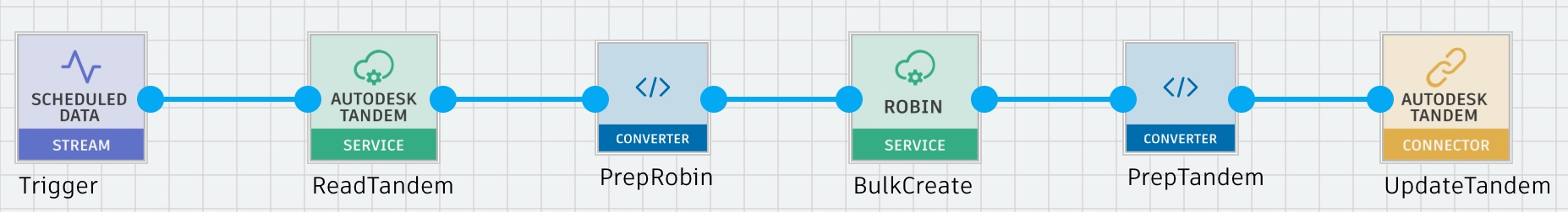

Solution Overview
TandemToRobinSetupPipeline
Components Involved
This section provides a detailed description of the components (plugins) that are part of the solution.
Scheduled Data Stream:
The scheduled data stream is the start of the pipeline where we can set how frequently the solution should run and update the properties. The scheduled data stream holds the properties that can be changed to customize the user defined properties that are defined in Tandem. Please refer to the Appendix for the JSON data that can be copied.
Autodesk Tandem Service
This plugin connects to the given Tandem facility and model to retrieve room / space information. The plugin is configured to retrieve only rooms with "Robin.SpaceId" property set as empty. This is achieved by passing the Attribute Filter from the scheduled data stream. The value suggests the plugin to only retrieve assets from Tandem that has the listed properties. The Robin.SpaceId at the end of the string can be changed to the actual user defined property defined in Tandem.
Converter (PrepRobin)
This converter maps Tandem asset data to the Robin Bulk Create payload format as below. For more information on the Bulk Create action please refer to the HELP section of the Robin Service plugin. It also prepares a map of Tandem Asset IDs used by the PrepTandem Converter to match spaces with Tandem assets for updates.
Robin Service (Bulk Create)
This service is configured to run in "Bulk Create" mode, creating necessary entities in Robin along with their dependencies if provided in the incoming data. It checks if the facility and rooms already exist in Robin, creating them if necessary. It sends JSON data along with created entity IDs to the next filter. If no entities are created, it indicates that objects already exist in Robin and no update is needed for Tandem.
Converter (Prep Tandem)
This converter receives data from the Robin Service Bulk Create action, which includes the newly created locations and space IDs. It maps space IDs with Tandem asset IDs so that the Tandem Connector can update assets. This is where we specify the custom Tandem asset properties to be updated.
Autodesk Tandem Connector
This plugin connects to the same Tandem facility as the earlier service plugin. It receives asset IDs from tcMetadata and updates properties (e.g., Robin Space ID) in the payload as below.
