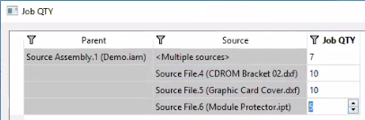

- Multi-Value: If you have added multiple assemblies to the nest, this enables you to control the quantity of each individual shape within the nest. Click
Details to open the Job QTY dialog box so you can enter quantities for each shape.
The multi-value feature applies to 2019.2 Update and later.

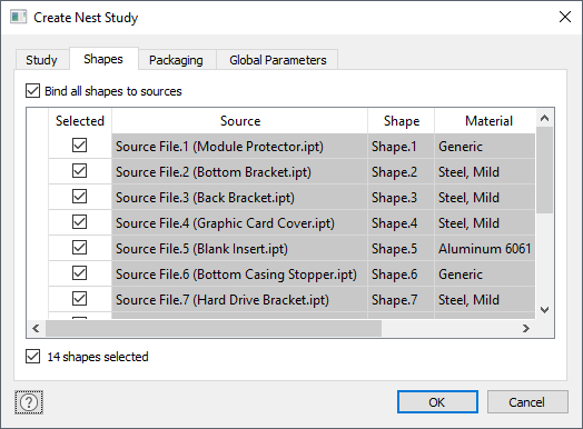

Set Up Shapes
- Click the Shapes tab in the Create Nest Study dialog.
- Select Bind All Shapes To Sources if you would like shapes in the nest to automatically be updated if their material or nesting properties are changed.
- In the Selected column, select which shapes you want to include in the nest.

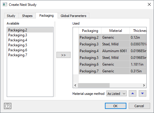

Set Up Packaging
- Click the Packaging tab in the Create Nest Study dialog.
The Used panel under Packaging is populated with all default packagings for the materials being used; these defaults are set in the Process Material Library dialog box.
- To remove a packaging from the Used list, right-click it and select Delete.
- To add an available package to the list, select it in the Available panel and click Add

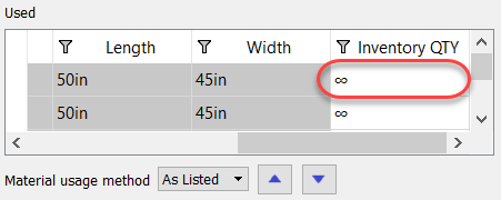

- To set a limit to the number of sheets of a certain packaging type that should be used, enter it in the Inventor QTY column in the Used list; otherwise, leave it set to Infinite (
For example, imagine that you have two packagings listed in the Used panel for the same material. You could enter an amount such as 2 for the first packaging. For the second packaging, you could enter Infinite, so that all remaining inventory for that material is created using the second packaging.
- To change how packaging is used for the nest, select an option from the
Material Usage Method box.
- As Listed: Inventor Nesting uses packaging in the order listed. All available quantities for the first packaging listed are used before proceeding to the next packaging.
- Best Mix: Inventor Nesting uses the most cost-efficient mix of packaging sizes. This is also the most efficient method for material use.
- Best Size: Inventor Nesting picks an optimal packaging size to use. If multiple sheets are needed, they are all of this size.

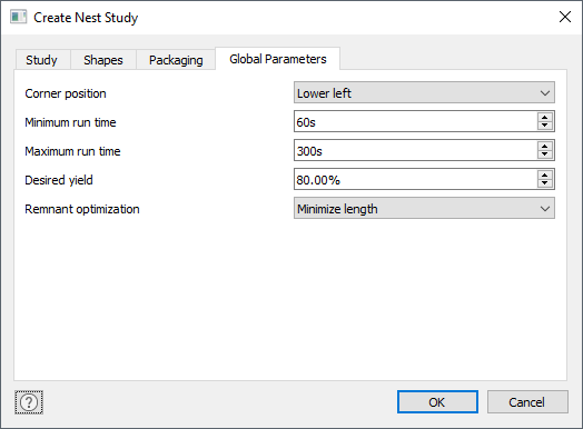

Adjust Parameters and Performance
- Under Global Nest Parameters, select a
Corner Position.
This is the primary corner where nesting should take place; for example if you select Lower Left, Inventor Nesting will attempt to nest the shapes in the lower left corner of the sheet as much as possible.
- Adjust Performance values.
- Minimum and Maximum run times: The minimum and maximum number of seconds to spend trying to arrange shapes on a sheet of material.
- Desired yield: If the nest uses this percentage of the sheet, it is acceptable. Inventor Nesting moves on to the next step, even if the maximum run time has not been reached.
- Remnant Optimization: Enables you to nest along either the longer or the wider side of the sheet for better management of material remnants. For example, if you select Minimize Width, priority will be given to nesting shapes lengthwise on the sheet, keeping width use to a minimum. Minimize Length X Width builds the nest out from a corner while trying to keep both length and width to a minimum.
Minimize Width Minimize Length Minimize Length X Width For Inventor Nesting Update 2019.3 and later, if a remnant length is longer than ten times the sheet length, the remnant area on a sheet will contain a break area (zig zag lines) indicating that the remnant is actually longer than what is displayed.
