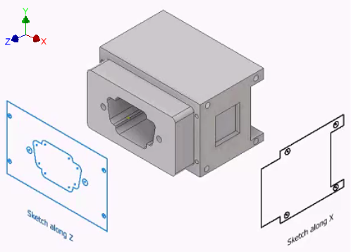

About Preparing Sketches and Extrusions in an IPT file
If your IPT file is a sheet metal file with a flat pattern, it can be extracted into Inventor Nesting without additional configuration. Alternatively, you can use regular IPT files that contain sketches and extrusions. While this is supported, you might need to manage which sketch or extrusion will be extracted into Inventor Nesting. This enables you to control how the extrusion is extracted into Inventor Nesting by creating a sketch of one side of the extrusion to use for nesting.
For example, suppose you create an extruded model with two sketches.
By default, when you bring this IPT file into Inventor Nesting, its shape is interpreted for nesting following this order of rules in the model browser.
- The last unconsumed (not used by an extrusion or revolve feature) sketch is used, provided it is the last node in the tree and is visible, or;
- The first extrusion in the model is used.
Objects that follow End of Part in the model browser are ignored.
Inventor construction lines are also ignored.

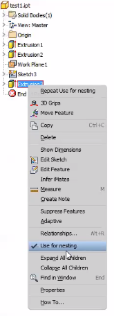

You can also specify in Inventor which sketch or extrusion to use for nesting from the IPT, instead of following the default rule.
- Right-click the appropriate node in the model browser and select Use For Nesting.

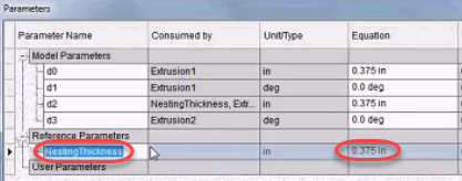

If you do this to an extrusion, Inventor Nesting creates a read-only Inventor reference parameter named Nesting Thickness and sets its value to the thickness of the extrusion.
After applying Use For Nesting, make sure to save the IPT after setting this value. When you add the model to Inventor Nesting, the sketch or extrusion you specified will be used for the nest. You can still change which sketch or extrusion is used after bringing in the model. See To Adjust Sketch and Extrusion Properties.

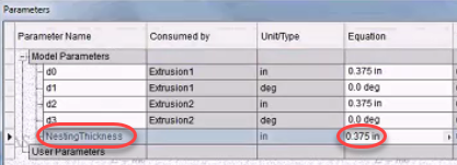

For situations like these where no thickness value is available, Inventor Nesting assigns a default value of 0.12 inches. Alternatively, you can assign a thickness value for Inventor Nesting from the model browser as follows.
- In the Inventor model browser, right-click the appropriate node and select
Nesting Thickness.
- Enter a value in the Thickness dialog box that opens.
- Save your file.
When you apply a nesting thickness to a sketch, Inventor Nesting creates a writable Inventor user parameter named Nesting Thickness with the value you set.
