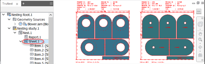

With this enabled, when you select a shape in the browser, it is shown in the application window.
If you select a parent node, all its shapes are shown in the application window.

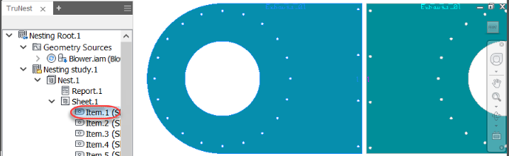

Select Shapes Using the Browser
- Select the appropriate shape or its CAD file in the Inventor Nesting browser to highlight its shape in the application window. You can also use the Up or Down arrow keys on your keyboard to navigate from node to node in the browser.

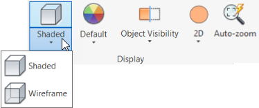

Show Shapes as Shaded (Filled) or with Wireframe Outlines
- Select the appropriate option on the Display panel of the
Inventor Nesting ribbon.
Shaded Wireframe

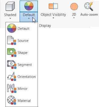

Color Shapes by Property
Assign colors to shapes based on properties, such as material, orientation, source, and so on. (This has no effect in Wireframe mode.) For example, if you base color on orientation, all shapes with no orientation will have one color, all shapes with a 90 degree orientation will have another color, and so on.
- Default: All shapes are given the default color that is set in the Display tab of the Options dialog box
- Source: Shapes are colored by parent file.
- Shape: Every shape is given a unique color.
- Segment: Shapes use their embedded color property.
- Orientation: Shapes are colored according to Orientation settings in Nesting Properties.
- Mirror: Shapes are colored according to the Mirror setting in Nesting Properties.
- Material: Shapes of the same material share a color.
