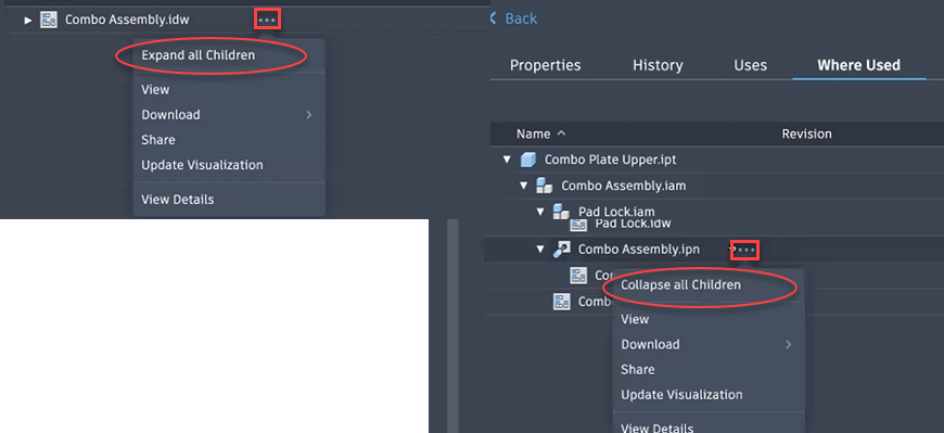

Expand/Collapse Rows
Expand or collapse rows in a tree view. This functionality is available in the File (Uses and Where Used tabs) and Items (Where Used and BOM) details page.
To expand/collapse all rows:
  • Click the Collapse all icon in the tree view action bar to collapse all the rows.
    Note: If the child rows weren't previously collapsed, they will appear in their previously-expanded state. Using "Collapse all" ensures that all rows appear in a collapsed state.
  • Click the Expand all icon in the tree view action bar to expand the collapsed rows (parent-rows-with-children) so that all rows are displayed in a tree view.
Expand all Children/Collapse all Children
To expand the collapsed rows in a tree view:
  • Hover over the parent row and click the ellipses icon (…).
  • Select "Expand all Children" to display all the rows.
Similarly, to collapse the expanded rows, hover over the parent row and select the ellipses icon (…) to select "Collapse all Children".
