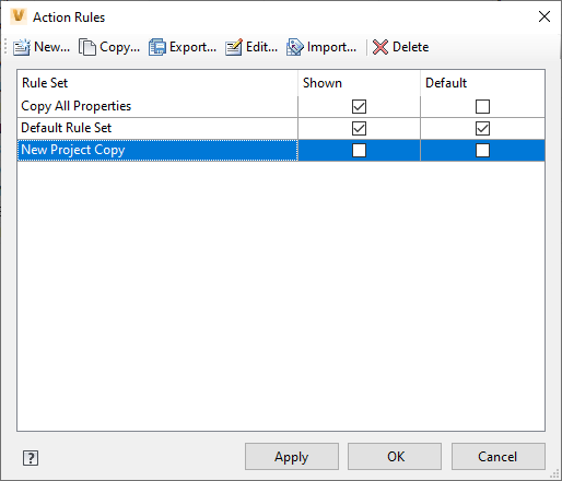

Manage Rule Sets
In the toolbar, click Options > Action Rules > Define to open Action Rules dialog.
Click New to Define an Action Rule Set.
Select an existing rule set and click Copy to create a new rule set with the same conditions and property settings.
Select an existing rule set and click Export to export the rules set as a XML file to a desired location.
Select an existing rule set and click Edit to make changes to the existing conditions and property settings.
Select an existing rule set and click Import to import an existing rules set from a desired location.
Select a rule set and click Delete to remove it entirely from the Action Rules list.
Click OK to save your changes.
