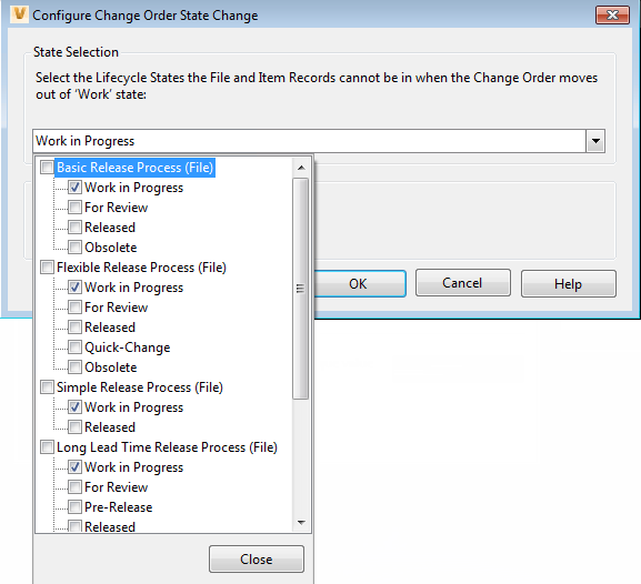

In the Vault Client, click Tools >Administration > Vault Settings.
In the Vault Settings dialog box, select the Change Orders tab.
Click Configure next to Restrict Change Orders from moving out of 'Work' state based on File and Item Lifecycle states.
Select the lifecycle states that an item or file cannot be in for the change order to move out of a work state.
Click Close.
Select whether you want these settings to apply to Items, Files, or Both.
Click OK to save your changes.
