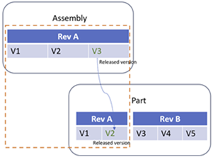

What does released biased mean?
Released bias indicates that released data should take priority over non-released data. It shows the latest file's version in the used revision. This option can be turned off.
What is the difference between Released bias and Revision bias?
Here is an example where we have an assembly and part both at Rev A.
- Released bias means that the display will use Rev A version 2 of the part and not version 3.
- Revision bias enforces that a Rev A of the assembly will always use Rev A of the part.

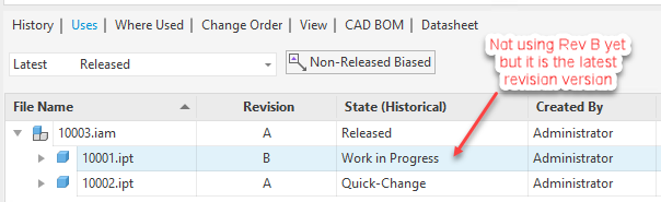

Let's see the Uses tab. The Uses tab lists the files used in the current model.
Click the view button
to toggle between released/non-released bias. Note that the view button is for viewing only; it doesn't change the state of the file/component.
- Released bias shows all the components as a Released state.
- Non-released bias shows the latest state of all the components.
The Latest represents the latest revision/version that the parent is linked to. The intent is to display the latest/version of every component associated with the parent. However, it does not necessarily mean that the parent is currently using that version.
The Released refers to the released version. The intent is to display the released version that is consumed.
- When the Latest is selected with the Non-Released Biased view
, the Uses tab displays the latest file's version. It shows the current stage of all the components/sub-components. - When the Latest is selected with the Released Biased view
, the Uses tab displays the released file's version if available. - When a specific Revision is selected with the Non-Released Biased view
, the Uses tab displays the latest file's version in the used revision. - When a specific Revision is selected with the Released Biased view
, the Uses tab displays the file's released version in the used revision if available.
