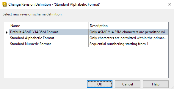

Click (...) to view the list of available revision scheme definitions. By default, only those revision schemes associated with the file category are listed.
Do one of the following:
- In the Change Revision Scheme Definition dialog box, select the new revision scheme that you want to assign to the selected file. Click OK.

Click Scheme to view the list of available revision scheme definitions. Only those revision schemes associated with the item category are listed.
In the Change Revision Scheme Definition dialog box, select the new revision scheme that you want to assign to the selected item. Click OK.
