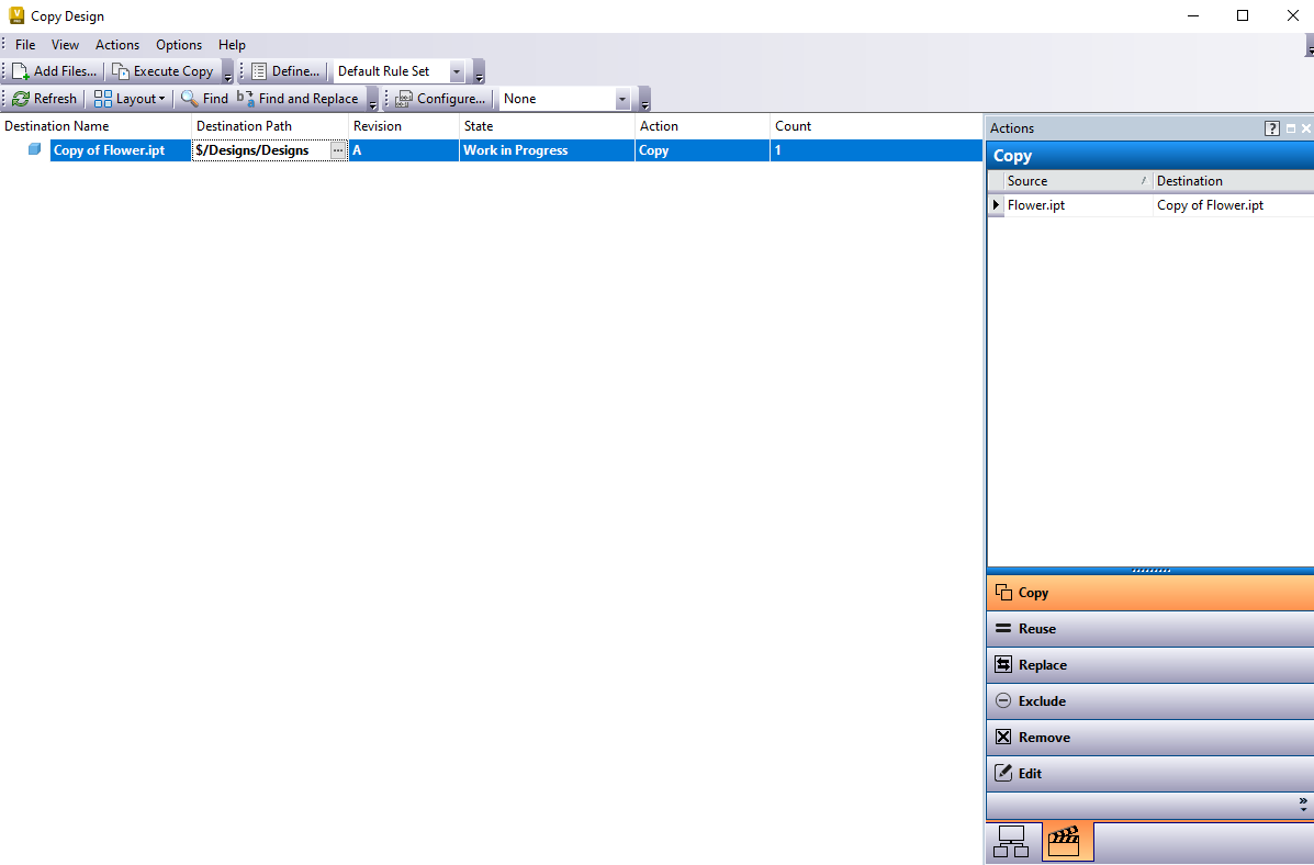

Create new design objects by copying existing data within a vault with the Copy Design feature. Depending on which design application you are using, copying a design involves copying a drawing and its related files, copying an entire design structure along with the related 2D drawings for 3D models, or copying components of a design.
Copy Design is now a modeless dialog with a toolbar: It can now remain open while you use the Vault client for other commands as well as add files to be copied.
The Copy Design feature creates a copy of the design with the same structure as the source files. In the Copy Design dialog, you can choose which parts of an existing design to copy, reuse, reuse branch, replace, exclude, or detach.
Copy Design Dialog
Note: If the files are modified as part of the copy design process, you must open the files using the Vault add-in within the appropriate CAD application after the copy design is completed. Rebuild and check the files back into the vault.
