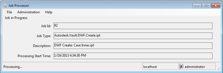

The Job Processor is a separate application that reserves queued jobs and pulls them from the job server to process them. Since the job processor is installed along with the Vault client, any workstation with the Autodesk Vault edition can be used to publish jobs.
From the Job Processor dialog a user can pause and resume processing, set the vault user account that is used to process jobs, and determine the types of jobs that the Job Processor creates and publishes.
Note: The Job Processor can be configured to launch automatically when the workstation is started in the Job Processor's Administration menu.
Job Processor Details
DetailDescription
Job ID
Displays the number of the job currently being processed.
Job Type
Displays a description of the job being processed.
Description
Displays more information about the job in the queue.
Status
Displays the current state of the Job Processor.
Status Bar
Displays the server name and the user account.
Processing Start Time
Time at which the Job Processor began working on a job.
