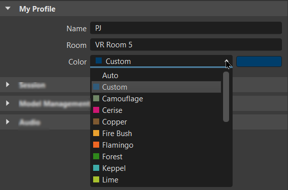

Setting the Room Parameter
The Room parameter, found in the Collaboration module, is used to let VRED know which VR participants are in the same real-world space. The room name for these participants must match exactly, this includes capitalization, spaces, and any punctuations. VRED takes the Room parameter, syncs and represents the participants within the tracked space, and uses this information for their safety twin.
To set a default room location, see Collaboration Preferences.

At the start of a VR session, each participant is automatically assigned a color. This color can be changed, during the session, with the Collaboration module's Color option. This color is applied to avatar parts with the colored\_part\_mtl material.
