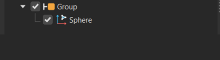

Group Icon Why a Group Node?
When creating a clone, if a non-group node object (a primitive with no parent) is cloned, it cannot be transformed separately from the original. Therefore, since both objects occupy the same space, one obscures the other, even when transformed.
Non-group node
Clone non-group node

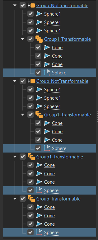

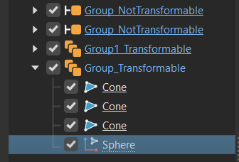

VRED provides visual clues, such as both node names underlined with a solid line, not a dotted, and not changing the node icons, that these "clones" won't behave as expected.
Non-group node

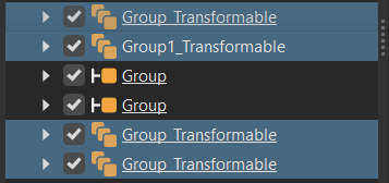

Visual Indicators of a Clone
In the Scenegraph, when a node is cloned, its icon changes from a group Group Icon to a clone Clone Icon icon. If it doesn't, this indicates that Tranformable Clone Root is disabled, and needs to be enabled. The child node names are underlined with a dotted line, visually indicating clone nodes.
Original Cloned (Tranformable Clone Root disabled)
Original object group node Original object group node and clone root node

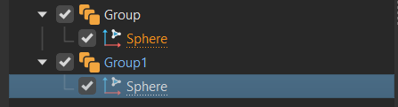

When a clone group's child node is selected, its parent node is highlighted blue and its clone nodes are orange.
Clone and parent visual indicators

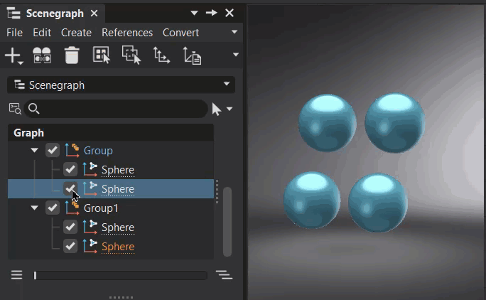

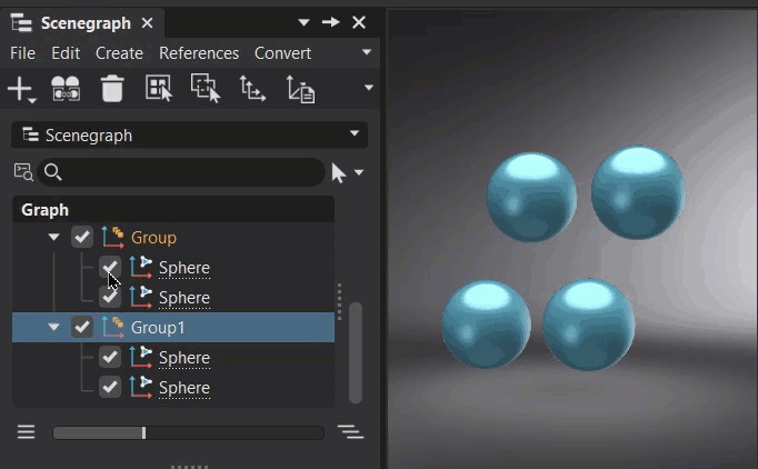

Syncing Clone Visibility
To sync clone visibility to show or hide all clones, enable Sync Visibility of Clones.
  1. Create a group, add a sphere, duplicate it, and from the menu bar, click Translate, then Shift-drag the manipulator to transform the duplicate. See Transforming Objects in the Viewport for accessing the different transform modes.
  2. Clone (Ctrl + Shift + D) the group, then transform it.
  3. Select Edit > Preferences > Scene > Scenegraph, then in the Cloning section, and enable Sync Visibility of Clones and Transformable Clone Root.
  4. Click Apply, then OK.
  5. In the Scenegraph, uncheck a cloned node to hide it and its clones.
Sync Visibility of Clones enabled
Disabling Clone Visibility Syncing
This is the default setting. To disable clone visibility, making it independent of the original object node or other clones, disable Sync Visibility of Clones.
  3. Select Edit > Preferences > Scene > Scenegraph, then in the Cloning section, disable Sync Visibility of Clones, but keep Transformable Clone Root enabled.
  5. In the Scenegraph, uncheck a cloned node to hide it without affecting the visibility of its clones.
Sync Visibility of Clones disabled

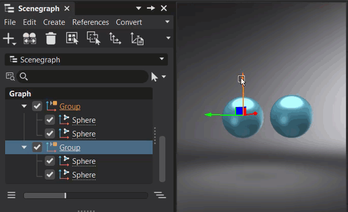

Independently Transforming the Clone Root
This is the default setting. To transform (move, scale, and rotate) the clone root independent of the original object node, enable Transformable Clone Root.
  2. Clone (Ctrl + Shift + D) the group.
  3. Select Edit > Preferences > Scene > Scenegraph, then in the Cloning section, enable Transformable Clone Root, but disable Sync Visibility of Clones.
  5. In the Scenegraph, select a group node and transform it.

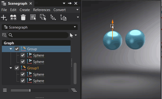

Constraining Clone Root Transformation
The clone root node cannot be transformed independent of the original object node when Transformable Clone Root is disabled. Therefore, the original object and all referenced clones are transformed at once.
  3. Select Edit > Preferences > Scene > Scenegraph, then in the Cloning section, disable Transformable Clone Root and Sync Visibility of Clones.
Transformable Clone Root disabled

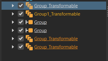

Selecting Clones
In the Scenegraph, use either the Edit menu or right-click to access the clone selection options. Select All Clones selects all clones of the selected node, while Select All Transformable Clones only selects clones that will be transformed, when the selected node is transformed.
Selecting All Clones
Select a clone or clone root node, then select Edit > Select All Clones. All nodes that are a clone of the selected node are selected, regardless of whether they are transformable or not.
Before Select All Clones
Example before using Select All Clones Example of Select All Clones
Selecting All Transformable Clones
Select a clone root node, then select Edit > Select All Transformable Clones. All clones affected by the transformation of this clone root node are selected.
Before Select All Transformable Clones
Example before using Select All Clones Example of Select All Transformable Clones
