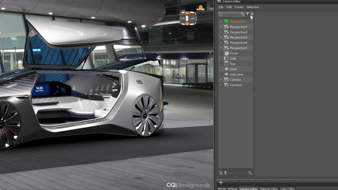

The decoupling of the Camera Editor is complete, making it possible to access all properties via the Python API. Menus and quick access icons have been added, making it easier to locate options and access frequently used tools. Use the search, filtering, and collapse/expand controls to locate cameras and viewpoints in the Tree List. Split the Tree List into two views for easier sorting/grouping. Improved the loading and saving of tracks and viewpoints. Also, when working with tracks, the number of tracks selected in the Tree List determines the number of tracks displayed in the Track View. And lastly, properties can now be changed on multi-selection for cameras and viewpoints.

The Search Bar and filtering provide live-search and filtering capabilities within the Camera Editor.
Search Bar and Filtering
Entering one character hides all cameras with names that don't include that character. Search by name, using the Search Bar. Only single search terms are supported.
  • Toggle Search Depth icon Toggle Search Depth - Toggles between flat and recursive matching. When disabled, only top-level matches appear. When enabled, matches deeper in the hierarchy appear.
    Original Flat Match Recursive Match
    Original tree Flat match shows only top level nodes that match Resursive match shows nodes containing a match deeper within the hierarchy
  • Toggle Type Filter icon Toggle Type Filter - Activated once a filter is performed. The cameras displayed are the result of this filter. It is automatically deactivated when the Select none filtering option is selected.
  • Filter icon Filter Selection menu - Use these options for configuring the filter settings. Use it, for example, to toggle between all cameras and only aim and up cameras.
    The Filter Selection menu contains all the ways you can filter cameras, from type to the following. Use these filtering options in conjunction with a search term to further define a search.

Tree List
The Tree List on the left lists all scene-contained cameras, camera tracks, and viewpoints, which can be grouped.
Camera, camera track, and viewpoint in Tree List
When a camera track or viewpoint is selected, its parent node text is highlighed blue.
Parent node text is highlighed blue
Double-clicking a camera activates and connects it to the Render Window. Clicking the camera loads its parameters.
Camera parameters
Right-clicking a camera accesses a context menu with options for creating, editing, activating, selecting, saving, and loading. For information on these options, see the Context Menu.
Camera context menu
