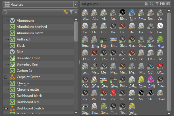

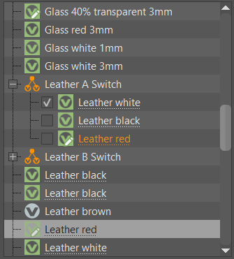

  • The Material Graph has a tree view similar to the Scenegraph for a faster and better overview of complete materials. Use the slider along the bottom to collapse or expand selected group hierarchies, such as switches.
  • We added icons for third-party material types to easily identify different and more complex multi-materials, such as OCS, Substance, and X-Rite.
    Third-party Material Icons
  • If two Material Graphs are displayed in the Material Editor, the last focused (last clicked in) one auto-scrolls to the selection.

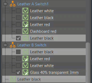

  • All materials referenced within a switch, multi pass, layered material or other group hierarchy are underlined. This underline indicates the material exists inside a group hierarchy.
    Underlined material in the tree
  • When selecting a referenced material or the reference itself, the main and sub-material are highlighted in orange.
    Main and sub-material are highlighted in orange
  • When using Select all Occurances icon Select all Occurances, group hierarchies containing the selected material are expanded with the parent text highlighted blue.
    Select all Occurances example

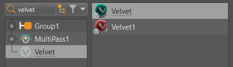

Filtering

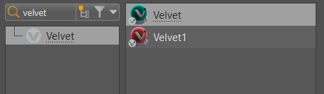

We added a search depth tool Toggle Search Depth icon and Filter Selection menu Filter icon.
Search Bar and Filter
  • Use Toggle Search Depth icon Toggle Search Depth to toggle between flat and recursive matching. When disabled, only top-level matches appear. When enabled, matches deeper in the hierarchy appear.
    Flat Match Recursive Match
    Flat match example recursive match example

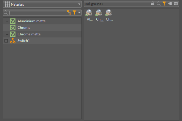

  • Use Filter icon to open the Filter Selection menu for configuring the filter settings. Use it, for example, to toggle between all materials and all Substance materials.
    Press-holding the button opens the dropdown menu
    Note:
    The search and filtering toggles in the Group Preview follows the search and filtering set in the Material Graph and Tag Lister.

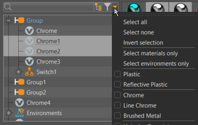

    The menu contains all the ways you can filter materials, from type to the following. Use these filtering options in conjunction with a search term and/or tag selection to further filter your search.
    • Select All - Selects all items, which is the default.
      Select None
    • Select None - Clears the filtering selection, reloading all the materials in the Group Preview. Filtering is automatically deactivating in both the Material Graph and Group Preview.
      Filtered After Select None
      Filtered material list Select None
    • Invert Selection - Deselected all previously selected items, and selects all items previously unselected.
    • Select Materials Only - Selects all materials, while deselecting everything else.
    • Select Environments Only - Selects all environments, while deselecting everything else.

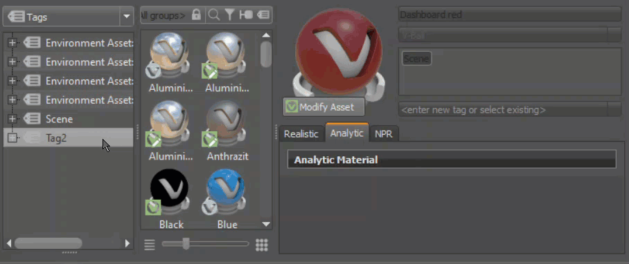

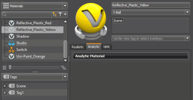

Now you can right-click and drag a tag from the Tag Lister into the Attributes Tag field to add it to that material. If the material is an asset material, Modify Asset will need to be activated, first.
drag a tag into the Tag area

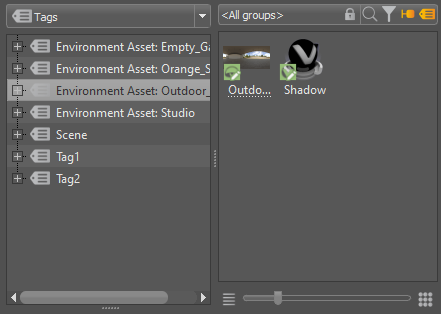

Use tags in conjunction with a search term and/or filters to further define a search.
Clicking a tag filters the Group Preview, displaying only the materials within the selected tag.
tag is selected
Clicking an empty space in the Tag Lister, resets Group Preview, displaying all materials.
Select None

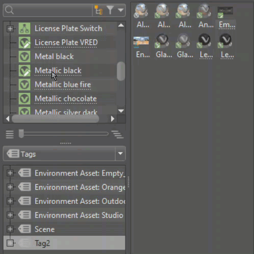

Click-dragging one or more materials onto a tag adds them to that tag.
Adding materials to a tag
Doing either of these adds a tag to a material:
  • RMB-dragging a tag onto a material in the Material Graph.
    Drag a tag onto a material
  • RMB-dragging a tag from the Tag Lister and dropping it into the Attributes Tag field.
    RMB-drag a tag into the Tags field
