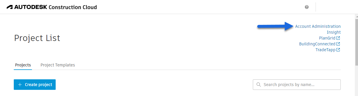

Step 2: Open Account Admin
After logging into your Autodesk Construction Cloud account, use the menu to access your Account Administration settings.

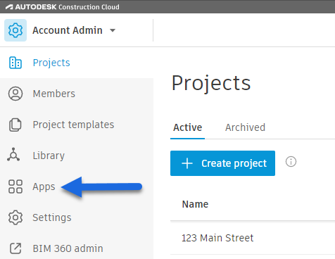

Step 3: Access the Apps Section
Once you are in the Account Admin menu, select the Apps tab as shown in the figure below.

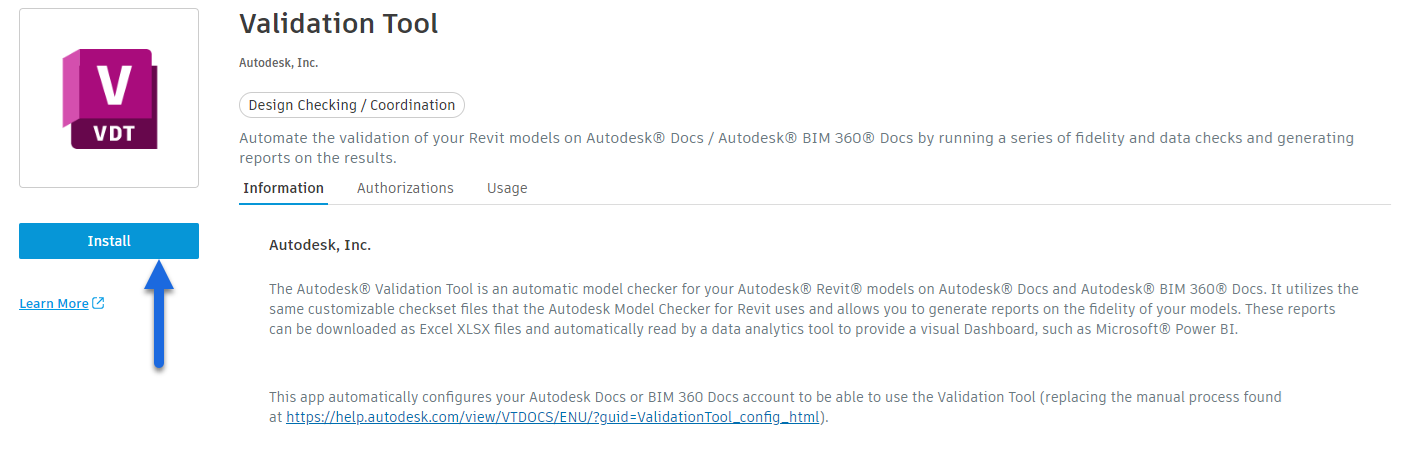

Step 4: Add the Validation Tool App
Select the Validation Tool icon from the list of Apps.
Then select Install as shown in the figure below.

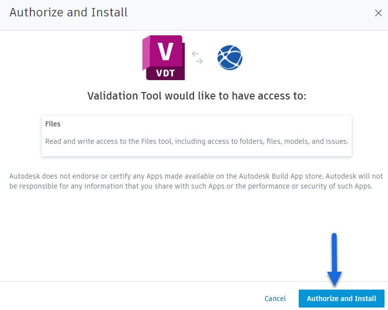

Step 5: Authorize and Install the App
Selecting Install will open a dialog box prompting you to authorize Read and Write access to the Files tool in Autodesk Docs.

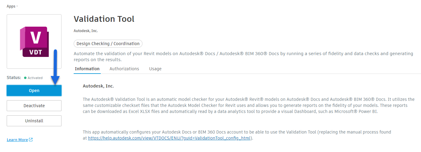

Step 6: Access the Validation Tool
Once activated, select open as shown below or go to avt.autodesk.com to begin checking models with the Autodesk® Validation Tool.
