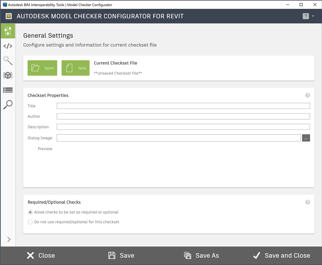

How do I create or modify a checkset?
The Autodesk Model Checker Configurator is available through the BIM Interoperability Desktop Tools and can be used to create and modify checksets for both AVT and the Autodesk Model Checker for Revit. The tool has pre-formatted checks to get started, or users can modify any of our public checksets.
