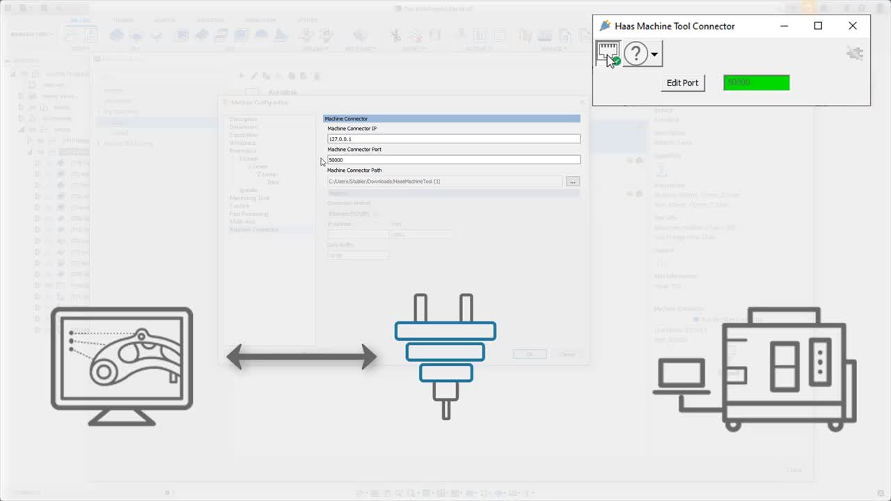

A Machine Connector is an application that enables Fusion to communicate with a specific CNC machine over a live connection. They are needed for importing inspection results in real-time for surface inspection, geometric inspection of critical features, and live part alignment.
machine connector
Example of a Machine Connector application for a Haas CNC machine.

  5. Enter the IP Address of the machine. You can usually find this on the machine controller, for example:
    machine definition
