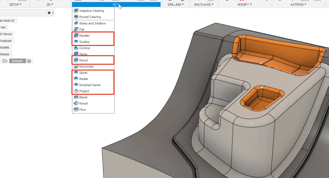

Using the Machining Type option in the Tool tab, you can enhance most 3D toolpaths to use multi-axis machining. Multi-axis controls define the orientation of the tool so that you can machine the part in the most efficient way.
Machining type
Multi-axis machining can benefit you by:
  • Reducing the number of Setups required - You can machine an entire part in a single setup using multi-axis machining. Machining without using multiple setups results in a reduced likelihood of errors related to setups.
  • Being able to use shorter cutting tools - Shorter cutting tools have less likelihood of deflection during machining, providing you with a better surface finish on your part.
Use the options on the Multi-Axis tab multi axis tab of a strategy dialog to:
  1. Define the tool axis for multi-axis machining.
  2. Automatically tilt the tool to avoid collisions. Ensure that any resulting tilting motion is smooth.
  3. Specify what happens when a tool exceeds the specified minimum and maximum tilting limits.
