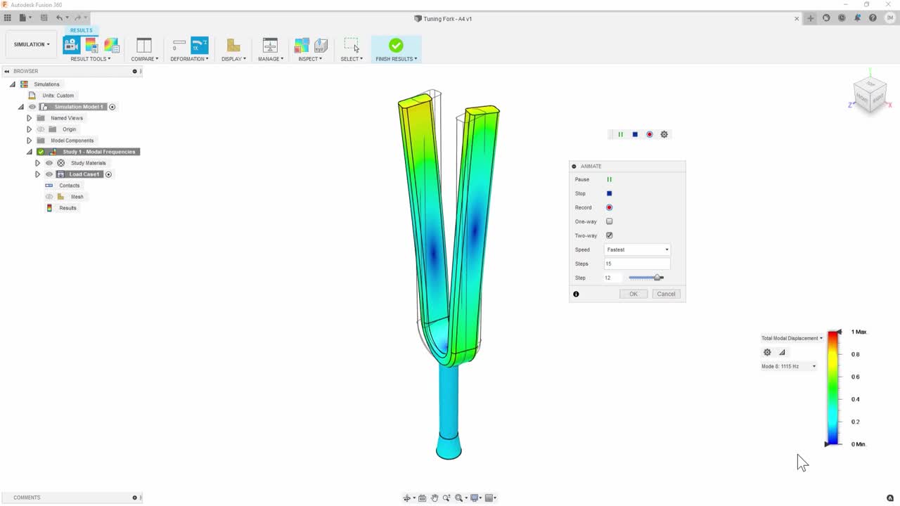

  14. Review the modal results:
    • Natural frequencies
    • Mode shapes
    • Mass participation factors
