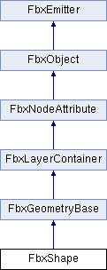

Inheritance diagram for FbxShape:Public Member Functions | |
