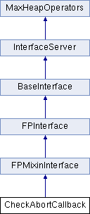

+ Inheritance diagram for CheckAbortCallback:
