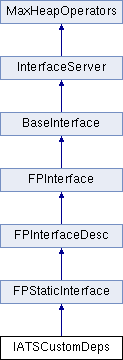

+ Inheritance diagram for IATSCustomDeps:
