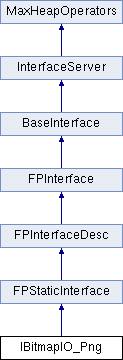

+ Inheritance diagram for IBitmapIO_Png:
