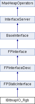

+ Inheritance diagram for IBitmapIO_Rgb:
