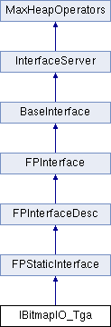

+ Inheritance diagram for IBitmapIO_Tga:
