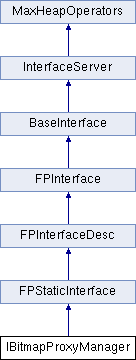

+ Inheritance diagram for IBitmapProxyManager:

- Public Types inherited from BaseInterface
enum  LifetimeType { noRelease, immediateRelease, wantsRelease, serverControlled }

- Public Member Functions inherited from FPInterfaceDesc

- Public Member Functions inherited from BaseInterface

- Public Member Functions inherited from InterfaceServer
