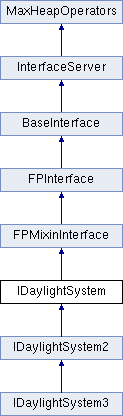

+ Inheritance diagram for IDaylightSystem:
