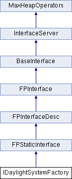

+ Inheritance diagram for IDaylightSystemFactory:
