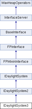

+ Inheritance diagram for IDaylightSystem3:

virtual void GetAltAz ( TimeValue  t,
float &  altitude,
float &  azimuth
pure virtual
Get the alititude and the azimuth angles of the sun at that particular time.
Parameters
[in]tThe time at which to get the alitude and azimuth of the sun.
[out]altitudeThe angle of the sun above the horizon. In radians, ranges from 0 at the horizon to PI/2 at the zenith.
[out]azimuthThe angle of the sun about north. In radians, ranges from 0 at due north, PI/2 at due east, etc..
