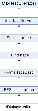

IDialogMonitor Class Reference
IDialogMonitor Class Referenceabstract
#include <IDialogMonitor.h>
Class Description
Interface to Dialog Monitor System.
This interface gives access to the Dialog Monitor System.
+ Inheritance diagram for IDialogMonitor:
Public Member Functions
virtual bool IsDialogMonitorEnabled ()=0
 Get Dialog Monitor state. More...
virtual void SetDialogMonitor (bool bDialogMonitor)=0
 Set Dialog Monitor state. More...
virtual bool IsInteractiveModeEnabled ()=0
 Get the Interactive Mode state. More...
virtual void SetInteractiveMode (bool bInteractive)=0
 Set Interactive Mode state. More...
virtual bool RegisterNotification (IDialogMonitorNotification *pNotification)=0
 Register for Dialog Monitor Notification Messages. More...
virtual bool UnRegisterNotification (IDialogMonitorNotification *pNotification)=0
 Unregister for Dialog Monitor Notification Messages. More...
