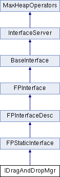

Manager class for Drag and Drop The Drag and Drop system is managed through a Core FP interface (DND_MGR_INTERFACE), defined by this class.
It provides control over the drag and drop system, manages handler registration and exposes some useful utility methods for downloading URL's, simulating drops, etc.
The DragAndDropMgr supports multiple DragAndDropHandler's registered against a single HWND window. This allows new components and 3rd-party developers to incrementally add handlers for new dropTypes to common windows such as viewports, that the default handlers don't know how to handle.
The IDragAndDropMgr::EnableDandD(HWND hwnd, BOOL flag, DragAndDropHandler* handler) method can be called multiple times on the same window with different handler instances. The drag and drop manager keeps track of all the DragAndDropHandlers on each window and will call their drag and drop event methods as needed, in order of registration, until one of them returns S_OK. For example, on a viewport, the DefaultDragAndDropHandler is registered by default. The event methods (such as DragEnter, DragOver, Drop, etc.) return E_FAIL if the dropping IDataObject or DropType is not recognized by them. Then, if a new component registers its own handler to deal with some new droptype, the default handler will fail to recognize the new droptype and so the new handler will be called to process the new drop type.
Note that this means DragAndDropHandler event methods must correctly return S_OK or E_FAIL depending on whether they handle the IDataObject or DropType currently dropping, so that the appropriate handler is found and called by the DnDMgr.
- Note
- In Max 2011, the management of DragAndDropHandler memory lifetime was changed. In previous versions, it was up to 3rd party developers to 'unregister' (Passing in FALSE to IDragAndDropMgr::EnableDandD) their drag and drop handlers (DragAndDropHandler*), before max was shutdown. If they didn't max would crash on shutdown. Now, unitialization has been moved up before 3rd party plugins are unloaded. Now, the manager automatically 'unregisters' all DragAndDropHandler pointers during a broadcast of NOTIFY_SYSTEM_SHUTDOWN. This means that the manager calls DragAndDropHandler::Release on all DragAndDropHandler pointers registered with it. After the manager cleans up during the NOTIFY_SYSTEM_SHUTDOWN broadcast, any subsequent calls to register a drag and drop handler will return FALSE. Also any subsequent calls to 'unregister' a handler will just silently do nothing.
- See Also
- Class FPStaticInterface, Class DragAndDropHandler, Class URLTab
