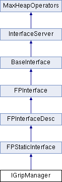

The interface to the functionality for using the Grip Manager.
This class contains key functionality for using grips. It contains functionality for setting which grip is active in addition to various options for how grips are displayed and manipulated. You get this interface by calling GetIGripManager(). This class is created by the system.
- See Also
- IGRIPMANAGER_INTERFACE
GetIGripManager()
