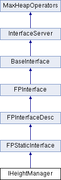

IHeightManager Class Reference
IHeightManager Class Referenceabstract
#include <IHeightManager.h>
Class Description
This interface gives access to the HeightManager.
The HeightManager has a list of heights for Metric, Imperial and Custom Units. All methods work on the currently selected display unit type If Generic is selected, the System unit will be considered in regards to which height-list to use. All Heights are stored in the 3dsmax.ini/3dsviz.ini file.
+ Inheritance diagram for IHeightManager:
