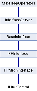

Base Limit Controller Interface.
ILimitControl provides access to the limit controller methods. A limit controller is used to restrict the range of values produced by other controllers.
The controller whose range of value is being restricted is called the limited controller. Its presence is optional.
This interface can be used to gain access to the limit controller's enable state and limited controller, and to set the upper or lower limits of the controller.
Limit controllers can be disabled, in which case they just let the limited controller pass through.
