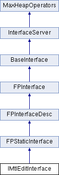

+ Inheritance diagram for IMtlEditInterface:
