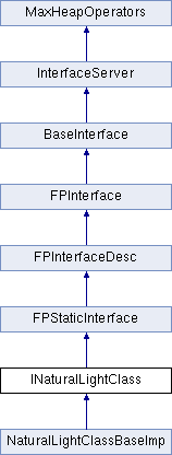

+ Inheritance diagram for INaturalLightClass:
