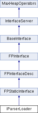

+ Inheritance diagram for IParserLoader:
