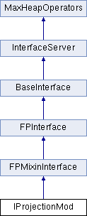

+ Inheritance diagram for IProjectionMod:
