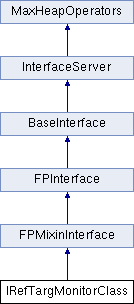

+ Inheritance diagram for IRefTargMonitorClass:
