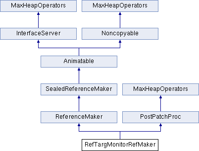

Defines a class for monitoring a ReferenceTarget by holding a weak reference to it (IsRealDependency returns false) and passing NotifyRefChanged messages to the owner of the class instance. The owner would create an instance of this class passing itself as the owner and the ReferenceTarget to watch as the target. The owner must derive from IRefTargMonitor, and would typically derive from IIndirectReferenceMaker. If the owner derives from IIndirectReferenceMaker, during scene load IIndirectReferenceMaker::SetIndirectReference is called to set the indirect reference. Thus, you wouldn't normally call this class's Save or Load methods from the owner if it derives from IRefTargMonitor.
Inheritance diagram for RefTargMonitorRefMaker:Public Member Functions | |
