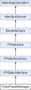

+ Inheritance diagram for IViewPanelManager:

- Public Member Functions inherited from FPInterfaceDesc

- Public Member Functions inherited from BaseInterface

- Public Member Functions inherited from InterfaceServer
