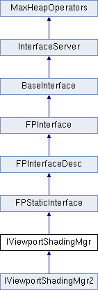

+ Inheritance diagram for IViewportShadingMgr:
