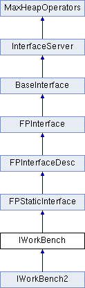

The interface to the CS Workbench.
This class contains all of the functionality found in the UI of the workbench. Note that these functions also affect the drawing and viewing of CS curves in the normal trackview. Thus you can extend the normal curve editor, via quad menus, etc.. to basically work like the workbench. You get this interface by calling GetCOREInterface(WORKBENCH_INTERFACE)
- See Also
- IWorkbench2
IAnylyzer
IFixer
IFilter
