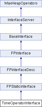

+ Inheritance diagram for ToneOperatorInterface:
