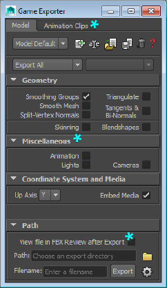

Game Exporter Updates
Improvements in the Game Exporter make it even easier to export your models or animation clips. The interface is now a little more streamlined, with separate tabs to organize the model export or animation export options. The preset groups of FBX options are revamped to be even more efficient, and the Model Default preset now includes options to control whether you include lights, cameras, and animation as you export a model.
In addition, the new FBX Review toggle lets you launch your exported file seamlessly in the FBX Review app. See Preview files with FBX Review.
