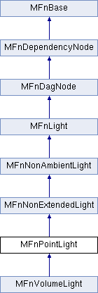

Inheritance diagram for MFnPointLight:Public Member Functions | |
